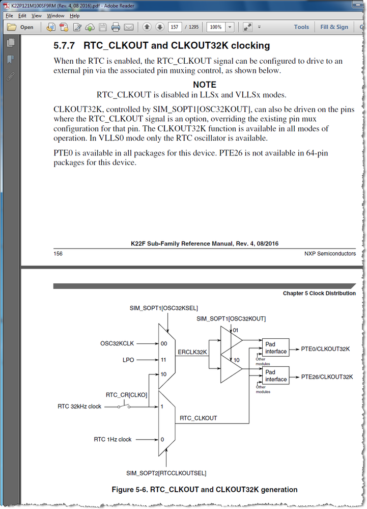

Is the 32 KHz clock for the k22f12810 chip enabled by default or with the call CLOCK_SYS_EnablePortClock(PORTE_IDX)?

If this isn't enabled by defualt what API would you use to enable this clock output.

Hi Brendan Merna,
It's not enabled by default.
Please refer the description in '5.7.7 RTC_CLKOUT and CLKOUT32K clocking' of K22P121M100SF9RM.

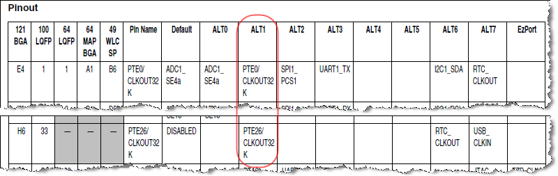

You need to configure the SIM_SOPT1[OSC32KSEL] \ SIM_SOPT1[OSC32KOUT] and configure PORTx_PCRn[MUX] select Alternative1.

brendanmerna
Thanks Robin! That's exactly what I needed. I was having trouble finding that in the data sheet. 32KHz clock works now.
