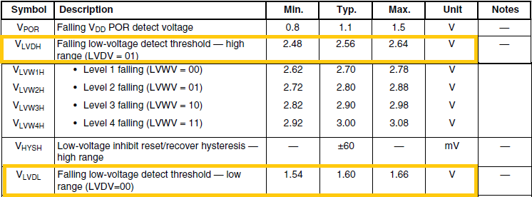

 I was looking at the data sheets there they mentioned no brown out is it is available or not.Could any one suggest me please.

Yes,Is it possible to configure the LVD with user defined value.I want to detect power failure  when chip voltage is less than 2.8V is it possible.

jorge_a_vazquez
Hi Jagadeesh Kumar
You can not configure LVD with user defined value, but you can select the voltage detect:
where:
Alternately you can use the "low voltage warning function" in the same module. I recommend you to check the chapter 15 of the Reference manual.
Hope this information helps you.
