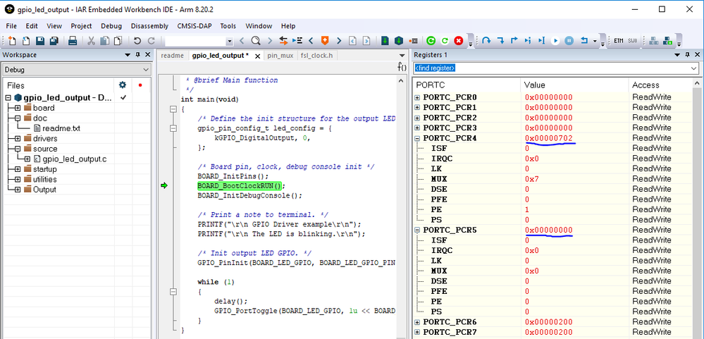

According to table in 33.2.2 Pin properties, PTC5 is pullup after POR.
But no description for PTC5 in Table 34-1. Ports summary.
Which description is correct?
I believe that Table 34-1. Ports summary is correct.
Anyway I would like NXP to correct this typographical error as soon as possible.
In addition please let us know when NXP correct this.

The PTC5 is not pullup after POR, because it's default pin function is not debug function.

Hi Takashima,
Test gpio_led_output example in SDK_2.3.0_FRDM-KE15Z, the PTC5 is not pullup after POR.
So I also believe that Table 34-1. Ports summary is correct.
I've will contact with the AE team for confirming. And I will inform you as soon as I get any feedback.
Thanks for your reporting!
