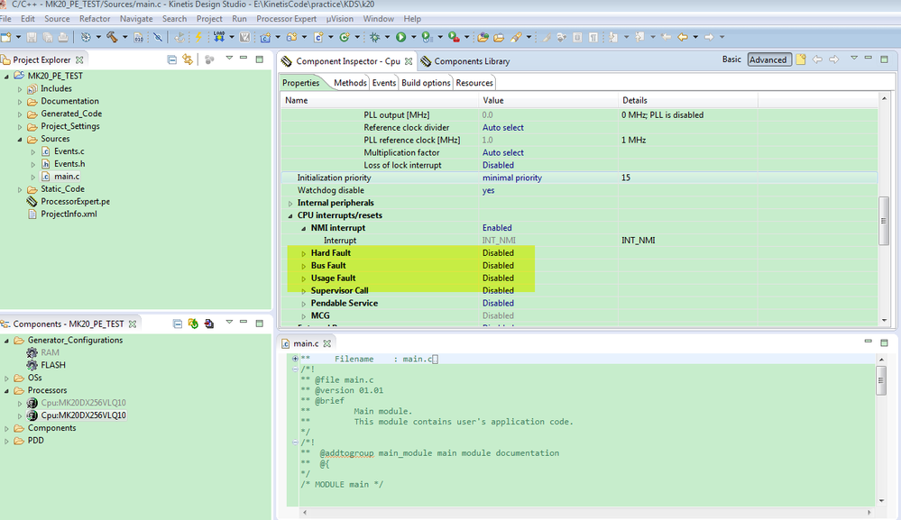

I am trying to write a exception handler to catch invalid function pointer calls for Uc MK20DX256(cortex M4). I was assuming a hard fault exception would be raised for such calls unfortunately that doesn't seem to be the case. I had enabled the hard fault in the PE cpu components. PE created a hard fault exception catch routine. Tried catching this exception by enabling a breakpoint in the exception catch routine but this break point was never hit. It would be great if anyone could give clarity on the following:

   In your PE configuration, don't just enable the hardfault, you can enable all the fault interrupt:

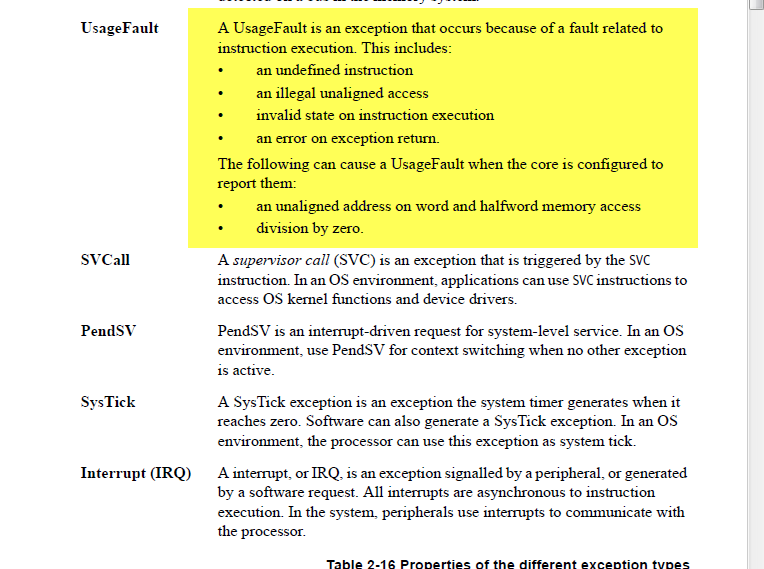

  I think you especially need to enable the usage fault.

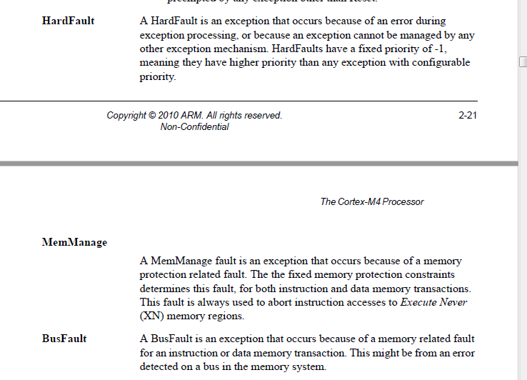

  From the ARM cortex-M4 device generic user guide, we can know these exception types:
So, enable all the fault interrupt, then try it again.
