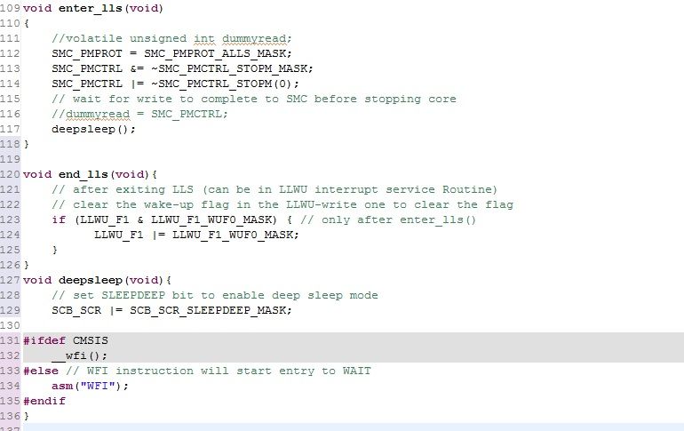

I'm using k20d72m tower and I'm working on going into low power and using an external interrupt to come out of low power. I think I have most of what I need code wise and CPU set up wise but I will put attachments of my code and such.
I have an infinite for loop that uses a PE timer that counts to 3 then goes into a while loop that holds the functions necessary for low power mode. Once the interrupt is detected, it goes out of the while loop and resets the timer and starts the cycle again. I do have a GPIO component for the external interrupt.
My problem is that when coming out of Wait, when I press the external interrupt less than five seconds (five seconds is an estimate) after it went into Wait mode, then the interrupt works but when I wait for more than five seconds, it takes two pushes of the external interrupt before it comes out of Wait mode. Then, for coming out of LLS mode, the external interrupt works once then doesn't work again. But, if I unplug and replug the device from power, it works whenever I use the interrupt and when I press Reset, it just never goes into LLS.

1) The 3rd line of code in your enter_lls() routine is actually going to set every bit in that register.  This will put the RUNM and STOPM bit fields in reserved values (yikes!).  So instead, try writing SMC_PMCTRL |= SMC_PMCTRL_STOPM(0); and see if that helps things.
2) Your end_lls() routine is actually unnecessary where you have called it in your main function.  The code in this function should actually be in your LLWU interrupt routine.

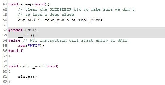

     I didn't realize there were PE LLS and Wait functions. I was going off the demo code that was available. I'll show you my enter_lls, end_lls,  and enter_Wait functions attached.

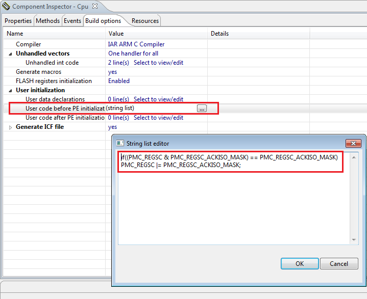

Turns out I have another question that you may be able to answer. So I used the low power PE code from the KL25Z sample codes and I'm coming across an issue for coming out of VLLSx mode. I am able to come out of low power with a LLWU interrupt but when it comes to the second time around, a LLWU interrupt doesn't work anymore.
I was reading that there are some flags I need to reset but I just am lost on which ones to reset...
I'm using the blue touch as an LLWU for VLLSx and here is my code...
PORTB_PCR2 = PORT_PCR_PS_MASK|PORT_PCR_PE_MASK|PORT_PCR_PFE_MASK|PORT_PCR_IRQC(10)|PORT_PCR_MUX(1);

So you say that it doesn't work the second time around?  So you enter VLLSx after a POR, and you are able to wake-up with an LLWU pin this time.  Then you go back to VLLSx and can't wake-up using an LLWU pin this time.  Is that correct?  Or are you entering LLS first and waking using an LLWU pin?

Right, it doesn't work a second time around. So I enter VLLSx then use LLWU to wake-up, then I enter VLLSx again and try to wake-up with LLWU but it doesn't wake-up.

It's been a while.  Sorry for the late response but I've been tied up on projects.  Are you handling ACKISO correctly?  ACKISO can be an easy thing to miss.  See the picture below for how it is handled in the low power demo.  Note that you may have to have more code than this (because you should be re-configuring your clock and any necessary pins before servicing ACKISO, but in the low power demo it is OK to handle ACKISO this way).
