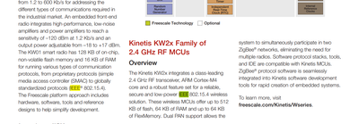

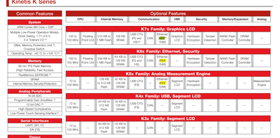

Hello @Prabhath ,
Thanks for your post.
Please refer to the Freescale Embedded Solutions Based on ARM Technology Guide - Brochure.
The Kinetis K series does not support IEEE 802.1X by NXP. Only the KW series supports it.
In addition, MQX 4.2 is no longer supported. You can consider using MQX™ v5 Software Solutions | NXP Semiconductors.
Sorry for the inconvenience. Thank you for your understanding.

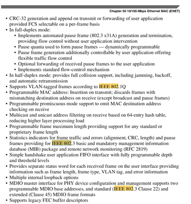

I would like to clarify a few more points. Is it possible to modify the application firmware to integrate IEEE 802.1X support?
714件の閲覧回数
Celeste_Liu
According to the RM, it supports IEEE 802.1q.
