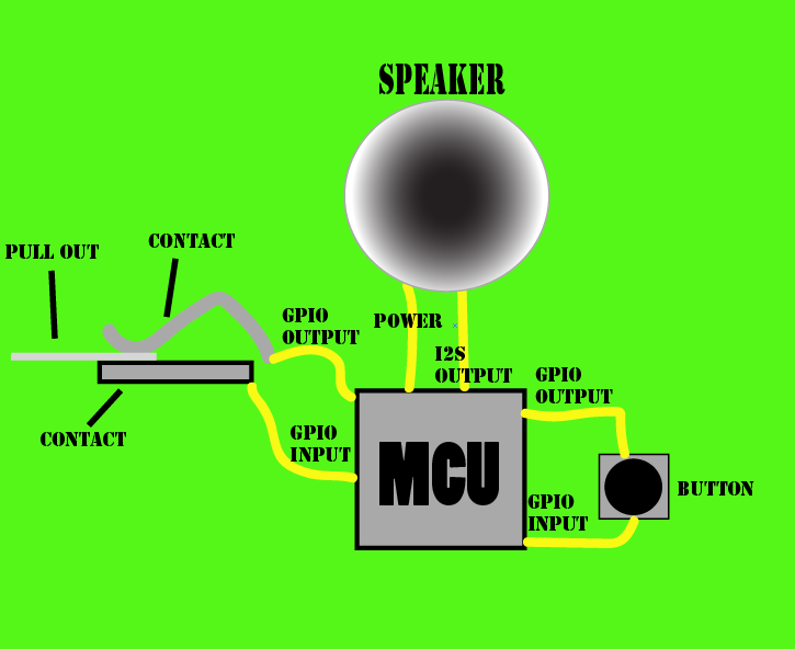

jackmonaghan
Ok so I've made a diagram of how the program/(part of the circuit) will be set out so you can get a much clearer picture on what i need to do sorry for the confusion with the "2 buttons" before.
so if you press the button but haven't pulled out the pull out it will play a noise on loop and when you press it
again it will turn off. But if you have taken the pullout out it puts it into an "ACTIVE" mode so as soon as you press
the button it will start playing and won't stop until the batteries die no matter how many times you try to turn it off.
define: GPIO, noise function, speaker function,
1. A low speed voltage is put through both the GPIO outputs.
2. Both the GPIO inputs keep sampling for any input.
3.Outcomes
     A. The "contact" gets an input and the button does as well it will jump to the part of the code where it will just play the noise on loop
     until the batteries die.
     B, Their is an input in the button function but not the "contact" functions it will start playing the code that just plays the noise on loop until the button is      pressed again to turn it off

mjbcswitzerland
Specialist V
I don't see the advantage of connecting one pole of the button/contact to a GPIO output - they can probably be connected to 0V and the inputs can connect an internal pull-up and monitor for a '0' to detect when the button is pressed or the contact is closed.
In your case you just need to configure these two pins as outputs driving 0V (or '1' and invert the input detection).
The rest of the logic (and what happens when the inputs are detected) is general software and so has nothing to do with the Kinetis GPIOs themselves.
