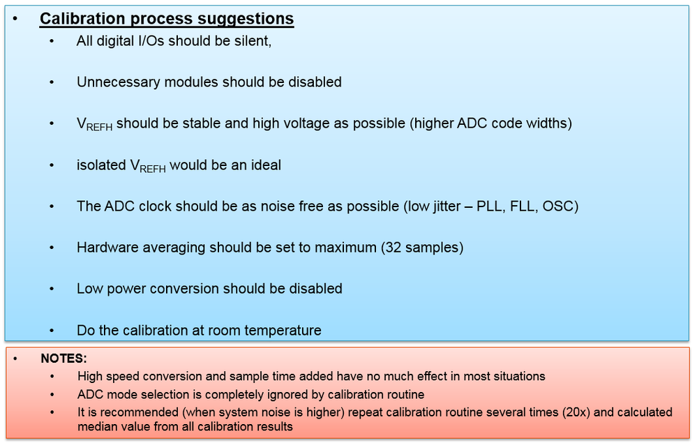

Hi Fred,
Please refer below picture, which shows some suggestions about ADC module calibration process.
Wish it helps.

fcw
Hi Hui_Ma,
Thank you for the reply. My histogram test follows those bullet practices other than the Vref which is fixed by the Freedom board. The fact that each of the individual histograms shows ~8 LSB variance indicates that the conversion is as low-noise as can be expected. But given that 8 LSB variance, why should the results over several calibration cycles show close to 64 LSB variance??? Which is my question 1...

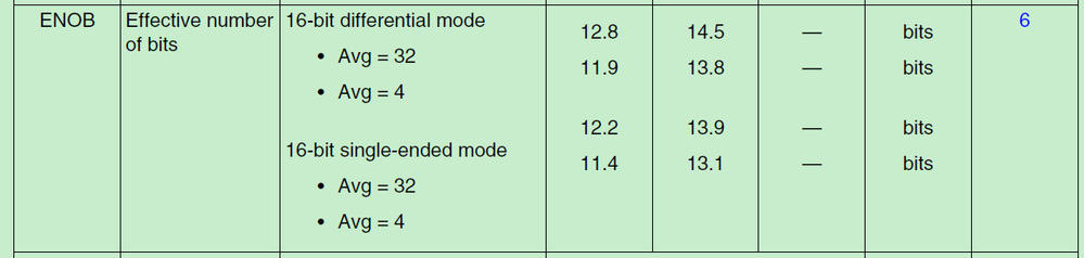

Thank you for the more detailed info, now I am quite understanding your issue.
The K64 datasheet shows the ENOB (effective number of bits) for 16-bit single-ended mode as below picture:
So we are confuse that K64 provides 16-bit(resolution) ADC, why the accuracy is just 13bits.
