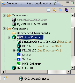

     In the CodeWarrior Components Library did not find the Quadrature Decoder component,but find it in the help documentation。

I think that component only shows up if your microcontroller actually has a quadrature encoder implemented.
You would need to disable the filter:

Thank you,but show “Target processor does not contain peripheral of this type”,I use MK10DX256ZVLQ10 MCU

Well, that means that your MK10DX256ZVLQ10 does not seem to have a hardware quadrature decoder.
What you could use instead the is a software encoder.
I'm using the 'QuadCounter' shown here: PID with Processor Expert

     I input the QuadCounter package, but it seems not implemented. Is there any problem in my Codewarior ?  Our Codewarior version is10.3 beta.
And do you have any samplesfor the component in PE?

Using MCU10.3 beta indeed could be your problem, as this was a beta a year ago, and there is already 10.4 available. I recommend that you use 10.4.
Use the latest version of the encoder from GitHub:
Home · mcuoneclipse Wiki · GitHub
This project described here Pololu Line Following Robot with Freedom Board | MCU on Eclipse
is using the two quadrature encoder. The link to the project sources are the end of that article.
