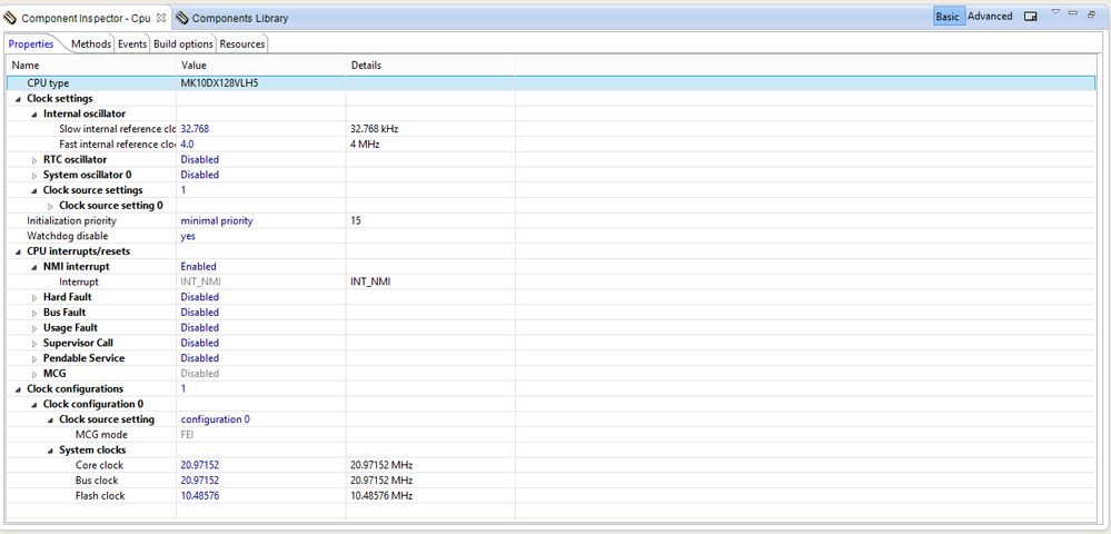

I'm using an MK10DX128VLH5 IC in my project. I want to give a delay of exactly 3 secs in between 2 operations. Is there an inbuilt function or something that can give me this exact delay??.
Meanwhile if u guys can help me with the amount of delay the followingfunction gives when run, it would help me solve the issue more easier. The following code is already used in an existing code which i need to change for an upgraded product.
Delay_t(20000);
void Delay_t(unsigned int i){
  int k;
while(i--){
    for(k=0;k<10;k++){
  asm ("NOP");
The CPU Configuration is as follows:
Please help ASAP. Plz let me know if any other information is required..
