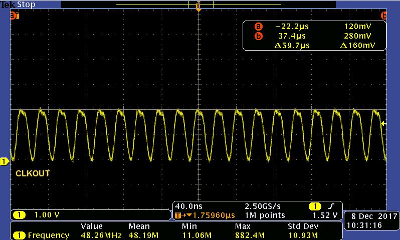

bmwhui‌ thank you so much. If you already tested it I have additional question:  How much is VDD supply used on scope and how much peak to peak is signal from CLKOUT pin?
I also tried it and it works down to 1.65 V. Maybe is really doucment issue - I hope.
    SIM->SOPT2 = SIM_SOPT2_CLKOUTSEL(7) ;          // Selects the IRC48M clock output on the CLKOUT pin.
    CLOCK_EnableClock(kCLOCK_PortA);                      // PORTA clock enable
    PORT_SetPinMux(PORTA, 12U, kPORT_MuxAlt5);    // Set PTA12 to CLOCKOUT
Is code correct? And signal is pretty weak - probably cause is oscilloscope internal resistance.

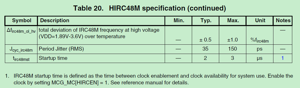

Hi Andrej,
Your test code is correct.
I check that info with Kinetis product team, the document mentioned chip VDD range 2.7V-3.6V is a suggested voltage range, which guarantee the output IRC48M clock accuracy for full temperature range.
While, customer still could low down the VDD voltage, while the output IRC48M clock accuracy could not be guaranteed in below datasheet description range:
So, customer need to evaluate the 48MHz clock signal clock accuracy in product application whole temperature range.
I don't have the test equipments to do that test. Sorry for that.
Thank you for the attention.
