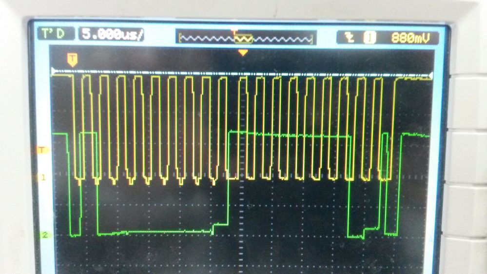

I have a problem connecting to I2C device.
This is how I read a register from the device
void INA226_ReadReg(uint32_t slave_adr, uint8_t reg_addr, uint16_t *value)
    uint8_t val[2];
    //first - write register address
    //for a write operation R/Wn bit should be low
    uint8_t slave_address = slave_adr  & 0xFE;
    //start
    I2C0_C1 |= I2C_C1_TX_MASK;
    I2C0_C1 |= I2C_C1_MST_MASK
    /* send slave address with W/R bit */
    I2C0_D = slave_address;
    //wait for ack
    while((I2C0_S & I2C_S_IICIF_MASK)==0) {}
    I2C0_S |= I2C_S_IICIF_MASK;
    /* set register address */
    I2C0_D = reg_addr;
    //wait for ack
    //stop
    I2C0_C1 &= ~I2C_C1_MST_MASK;
    I2C0_C1 &= ~I2C_C1_TX_MASK
    //second - read from written register address
    //slave address for read
    slave_address = slave_adr | 0x01;
    //repeated start
    I2C0_C1 |= I2C_C1_RSTA_MASK;
    //wait for ack
    // Put in Rx Mode
    I2C0_C1 &= (~I2C_C1_TX_MASK);
    // Turn off ACK since this is second to last byte being read
    I2C0_C1 |= I2C_C1_TXAK_MASK;
    val[0] = I2C0_D;
     //wait for ack
    val[1] = I2C0_D;
     //wait for ack
    *value = (val[0] << 8) | val[1];
    //stop
It stucks on wait for acknowledge.
May be I do something wrong?

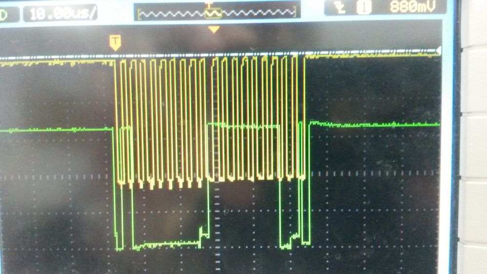

john71
Senior Contributor I
I replaced
with
          timeout++;
          if(timeout > I2C_TIMEOUT)
            return I2C_ERROR;
And now I see the first part - slave address and register address. But no repeated start.i2c_1.jpgi2c_2.jpg
