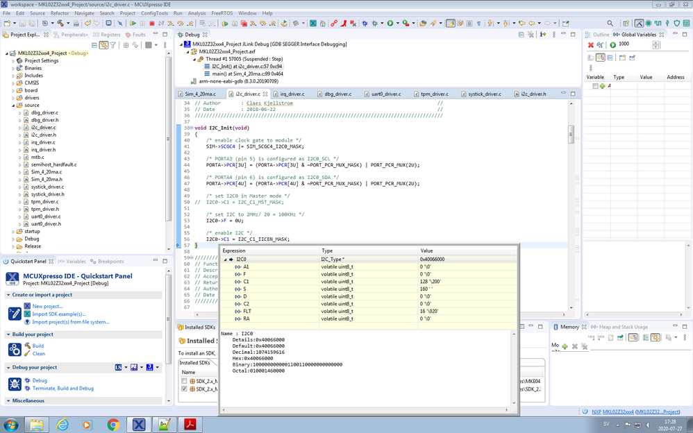

claeskjellstrom
Hi Kerry,
Just took a screendump and question is why is the bus busy ?. ->S TCF=1 and BUSY=1
Claes

kerryzhou
Hi claes kjellstrom,
  Do you connect one I2C master and one I2C slave in the I2C bus, or connect more master or slaves?
  Or one KL02 as I2C master, three slaves on the bus(24LC02,LPS25HB and LSM6DS3)?
   You can leave only one slave on the I2C bus, whether you still meet the debug I2C busy issues?
