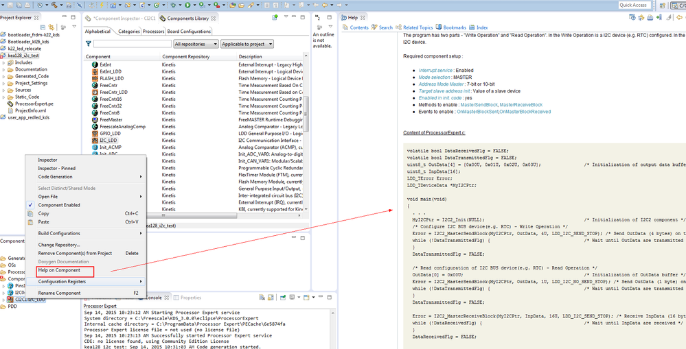

Hello vignesh,
Which IDE do you use ? If you use KDS, there have I2C demo code on "Help on component " :
Wish it helps

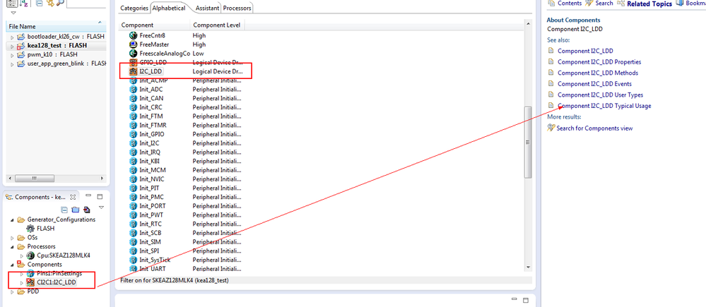

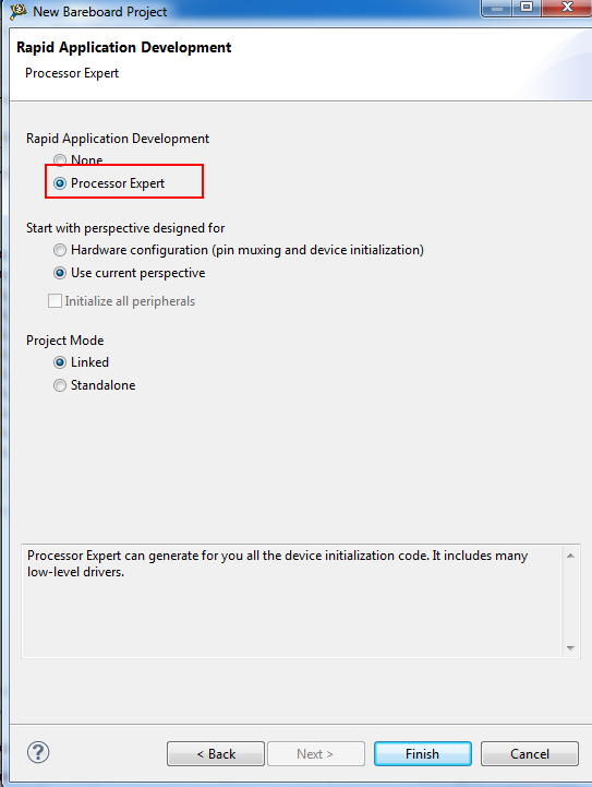

Hello balaji,
In CodeWarrior,  it also have the demo , when you create project ,please select "Process  Expert" , then add "I2C_LDD" component :
Alice

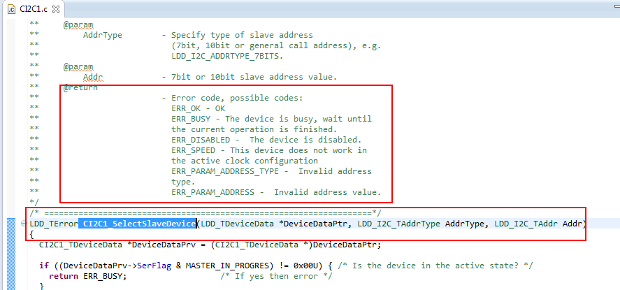

Hello ,
(1) First please be sure the correct of the connect of your hardware , for i have not the MMA8451Q chip , so i can not test,
while i recommend you can use the function " CI2C1_SelectSlaveDevice()" of PE to check whether the slave "MMA8451Q" is ok on I2C bus.
