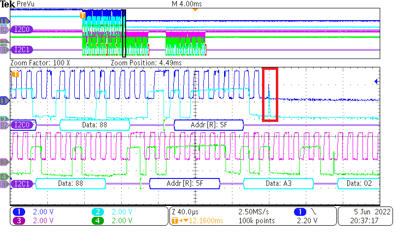

I'm running FreeRTOS and I have two independent threads (of the same priority) running I2C communications for two separate I2C buses on a K64 family microcontroller. Each thread polls a device and then sleeps for 1000 ms.
When the two threads are started via the vTaskStartScheduler() call, they run near concurrently, and after a few minutes one of the I2C busses is hung. I grabbed a  couple scope captures and show that the clock signal seems to be corrupted. See "communication_failed_1.png" and "communication_failed_2.png"
However I staggered the threads such that one had an initial delay so that the two threads ran near sequentially, and there never was an issue with the communication. See "staggered_thread_start.png".
Has anyone observed something like this? Is there a configuration required to allow communication on two independent I2C busses to run concurrently?

Hi Erich,
Thanks for the response. I do believe they are strong enough, the I2C lines are pulled up to 3.3V via 2.2k resistors.
I agree, it looks like some cross talk, however I was attributing that to coupling with the scope probes.

2.2k sounds good (in many cases only 4.7k are used and are usually good too).
I'm wondering if you are doing anything special in your I2C transmit/receive operations (maybe changing the I2C hardware somehow). I would make sure and check if plenty of stack/memory is allocated for each task, just to get a possible memory/stack overflow out of the equation. Just a rough guess.

Hi Erich,
I doubled checked, and each task is only using 25-30% of its allocated stack, so I don't think its a memory/stack overflow.
The I2C buses are configured in the auto generated board.c/peripherals.c files.
As for the transmit receive operations, I'm using the I2C_RTOS_Transfer() API. I set up the transfer structure and then call the API function. The microcontroller is continuously polling various status parameters from the slave devices. I have the following code snippet repeated for the ~20 status parameters, then the task sleeps for 1 second and then polls again.
The communication does work for a few seconds then after a few minutes one of the two buses hangs.

I think I cannot comment much. Have mostly used a single I2C bus with multiple tasks, and using a mutex to implement the serialization. I have a few applications using two different I2C on Kinetis, accessed each by multiple tasks, and guarded with mutex too, and never faced such a problem.
But I have not used that I2C_RTOS_Transfer() API: I always used a direct API guarded with that above mutex. Not sure if this helps.

Are your pull-ups strong enough? At least some signals show some kind of cross-talk (not sure from the pictures).
I would check if using stronger (external, of course) pull-ups will help.
