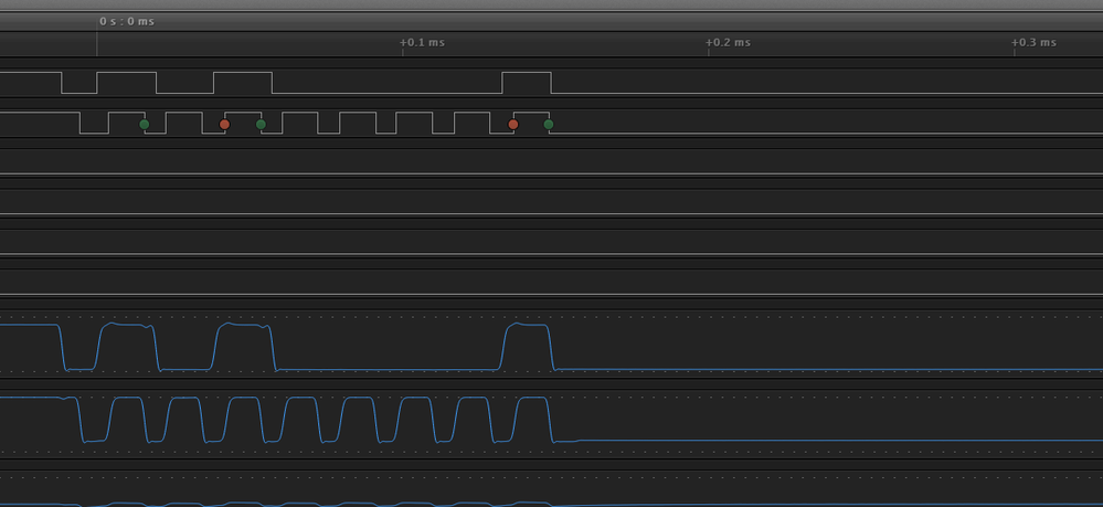

I'm having an I2C issue with my kinetis MKE04 and was wondering if anyone could help me out?
The problem is this:  I have the kinetis set up as a slave on an I2C line, and am trying to manually ACK.  I am ACKing when I get an Rx or Tx request, on reception of a byte and block.  I, however, am seeing a strange issue.  There is an EEPROM on the I2C bus, with address 0x50 (the kinetis is at 0x54).  When it's address is being called, the clock line is being held low by the kinetis (as when I disable manual ACKing, this doesn't happen).  Can anyone think of why this is happening?

  1. Please also provide the I2C problem wave.
  2. Please provide the KE04 slave code.
  3. Please check the KE04 slave address register with debug, just to make sure the address is correct, and also give me the debug picture.

Thank you so much for your reply.  I have included the code for the onBusStartDetected event, as this is the only one that is hit by the code at the moment.  The code is basically just for tracking repeated starts.  In the scope trace, you can see that the bus freezes after the r/w bit.  In the debug window, you can see that the 7 bit address is 0x54.  I tried to pick some other useful registers to show - it looks like the bus is busy but the peripheral knows it isn't being addressed...

    In your I2C wave, why just 8 bit data in the clock, it seems the master didn't send out the ACK bit in the clock, it should be 8 bit data +1 bit ack.
Kerry

Yeah it is strange - it's as if the peripheral is waiting to be told wether to send an ACK/NACK, except that the address being called is for a different peripheral.

    So you still need to check your I2C master, actually, even you don't connect the slave, the master still need to send out 8bit+1bit ACK.
