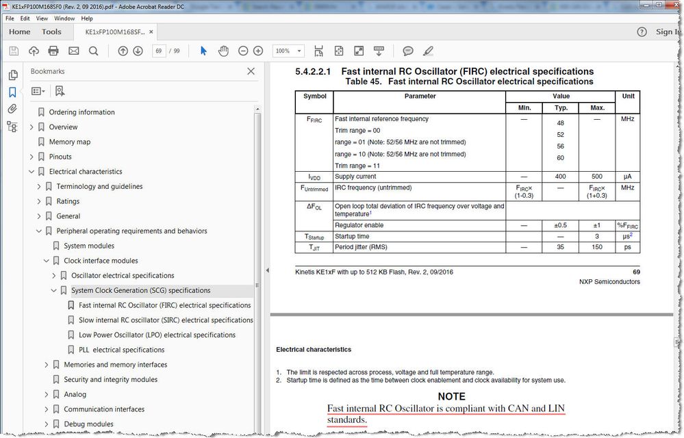

I want to use FIRC clock source to config FlexCAN module ,But it failed. So I want to check Whether support FIRC clock source as CAN Protocol Interface (CPI) clock

There is a note in the datasheet(KE1xFP100M168SF0) of Kinetis KE1xF.
Fast internal RC Oscillator is compliant with CAN and LIN standards.
