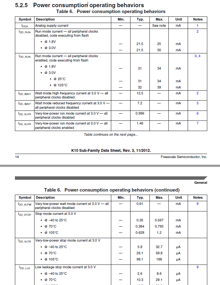

Hi, I'm using K10P100M72SF1 MCU.
I want to know there is a K10P100M72SF1 power consumption calculation tools.
or, Is there tips check power consumption about used pins?
1 返信
672件の閲覧回数
kerryzhou
Hi sungjoong park,
    Unfortunately, we don't have the power consumption calculation tools.
   Normally, you can refer to the kinetis datasheet find the each power mode power consumption:
      Power consumption related to the the power mode, and the module, core frequency you are using, not just the pins.
Wish it helps you!
If you still have questions about it, please kindly let me know.
