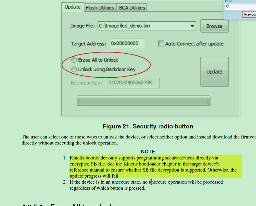

But i want to secure that .bin file with the key. So no one can hack my file and no one can get an actual data from .bin file.
6,075 次查看
kerryzhou
Hello rohit chudasama,
   Thank you for your detail information.
   Please refer to my attached file.
Page 14,
4.2.2 Browse button
Click the "Browse" button to locate the application image that is written to the Kinetis device. Currently, the supported file
types are .bin, .sb, .hex, .s19, and .srec.
The KinetisFlashTool support the .sb file download directly.
Wish it helps you!
If you still have question, just kindly let me know!
Kerry

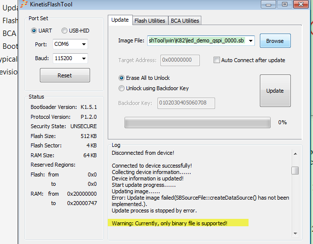

rohitchudasama
In the first que i mentioned that i am getting an error while uploading .sb file using KinetisFlashTool.
I make simple hello_world code and generate hello_world.bin file. After that i make hello_world.bd file and at the end using elftosb.exe i generate hello_world.sb file. But when i am trying to upload that i am getting below error :
 " Connected to device successfully! Collecting device information...... Device information is updated! Start update progress...... Updating image...... Error: Update image failed(SBSourceFile::createDataSource() has not been implemented.). Update process is stopped by error "
my hello_world.bd file is below :
sources {
# BIN File path
myBINFile = "hello_world.bin";
section (0) {
#1. Erase the internal flash
erase all;
#2. Load BIN File to internal flash
load myBINFile > 0xa000;
#3. Reset target.
reset;
6,075 次查看
kerryzhou
Hi rohit chudasama,
   Sorry, my fault.
   I have test it on my side. KE18 bootloader can't support the SB file download.
Kerry
