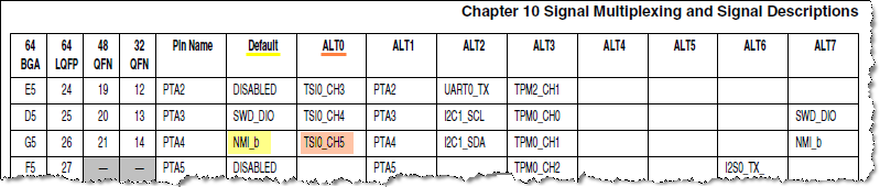

I used pin NMI(PTA4) of KL16 is pin TSI have problem? Can someone explain to me? Thanks.

Hi Hoang Nguyen,
The PTA4 is default as NMI_b function, driving the NMI_b signal low forces a non-maskable interrupt.
If you want to use PTA4 as TSI function, please disable NMI function by clearing NMI_DIS.
Please refer: Disabling NMI using the FOPT register (on KL17).
Robin
