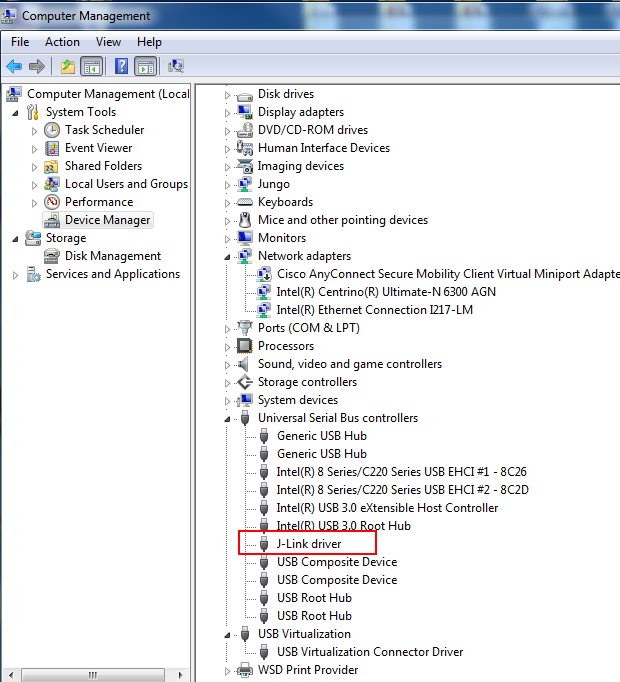

Hello Mauro,
Do you mean can not connect the FRDM-k64 board ?
If yes , please update the bootloader :
(1) Unplug the USB cable if attached.
(2) Press and hold the Reset button (SW1). Plug in a USB cable . Release the Reset button.
(3)  Copy & paste  "JLink_OpenSDA_V2.bin" ( the attachment)  to the BOOTLOADER drive.
(4)Unplug the USB cable and plug it in again.
Then in the manage of computer ,  you will see :
Alice
