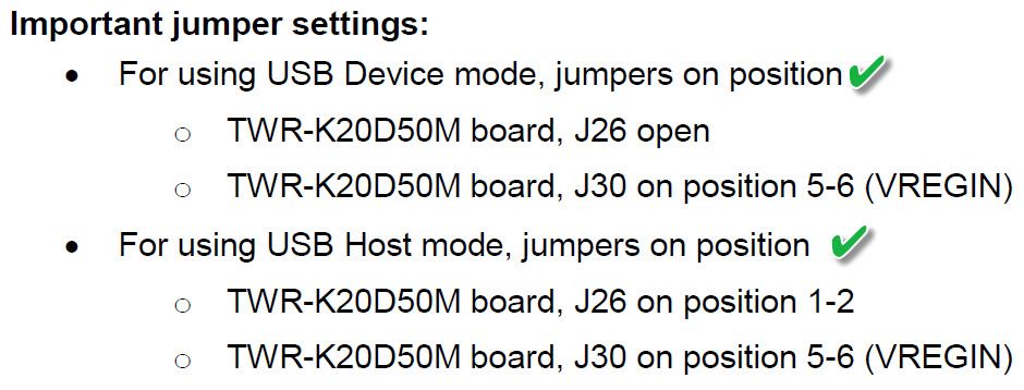

I have a TWR-K20D50M. I can get the MQX example to run for a USB Host. I cannot get the USB Device examples to run or enstantiate with my PC..

This is an out-of-the-box situation where I am evaluation this Microcontroller for use in a USB Device.  The USB Host code works just fine (I'm hosting a mouse right now).  I cannot get any of the USB Device examples to run at all.  I have tried the examples from "Freescale USB Stack v4.0.3" with no success as well.  Anu ideas?

Hi Alan,
Please check the hardware configuration whether suits for the relevant USB demos or not.

You can get TWR-K20D50M USB device (including accurate simulation) support from http://www.utasker.com/kinetis/TWR-K20D50M.html (even if only to check that your board works correctly).
