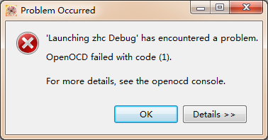

The program can't be downloaded or debuged  to the KE15Z FRDM.
Here is what I do to the KE15Z FRDM.

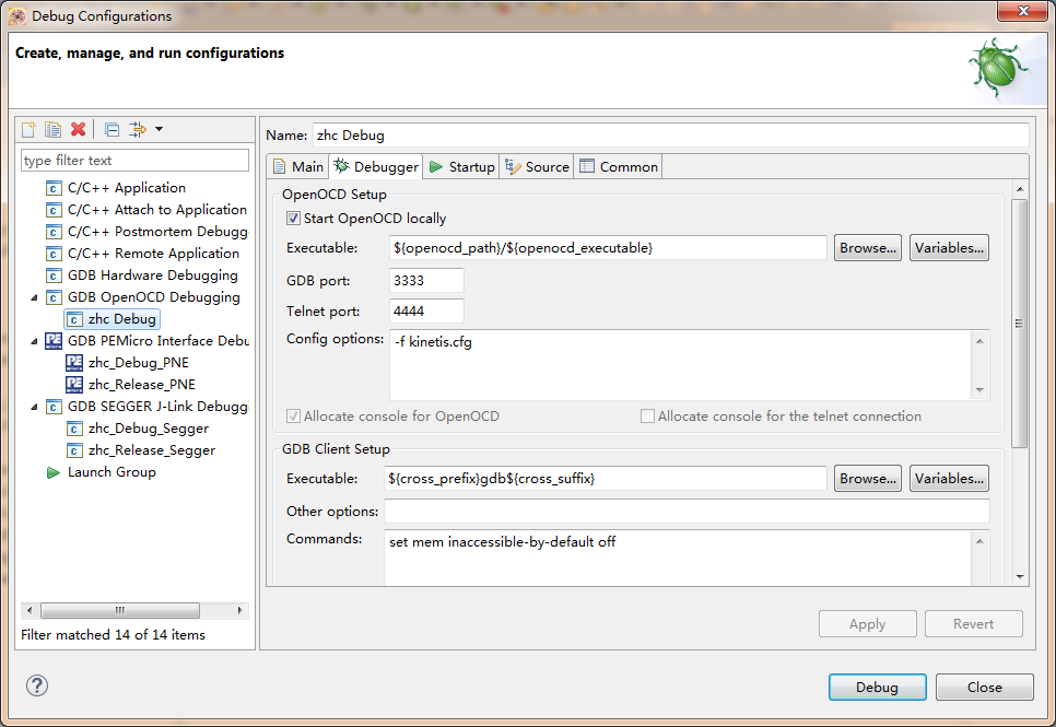

3 open the project by KDS(the latest version),build up the project
click on the debug button,
If you know where i am wrong ,please help me

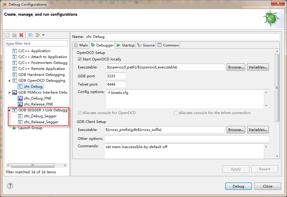

Hi aline,
Since you have download the OpenSDA V2.1 J-link Firmware, you should select GDB SEGGER J-Link debugger.
