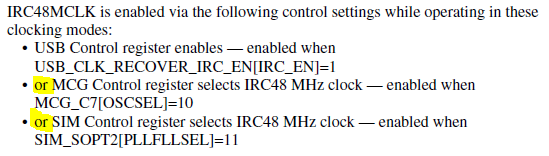

mjbcswitzerland
Specialist V
Hello Jorge
>>Could you point me to the manual version and the chapter that had you confused?
Chapter 5.7.2 in user manual K64P144M120SF5RM Rev. 2. January 2014
The OR is not correct in devices with the issue since it is "only" enabled by USB.
This still looks to be the most up-to-date user's manual.
In fact I didn't expect to find any information about deviations here but rather in an errata - however the only errata is 1N83J, which doesn't mention this.
This means that the only source of the notice about deviation to the user's manual is in an application note, which is not particularly logical.
Mark
