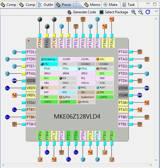

I have a problem with Kinetis studio, I can't share the pins because the expert mode is not settable there are only basic and advanced.

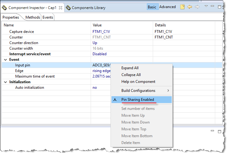

Robin_Shen
Hi GABRIELE VALLESI,
Right click the pin that you want to share, and then enable it.
Robin

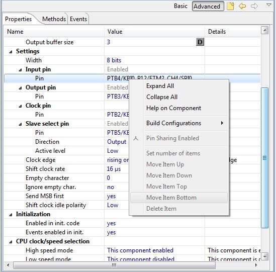

piergiacomi
Hi Robin,
thanks a lot for the answer, but my problem is that the Pin Sharing is disabled
thank

Robin_Shen
Would you please tell me the part number of your MCU?
Please also show me which component of Processor Expert are used.
Robin
1,665 Views
piergiacomi
Hi Robin,
I'm using MKE06Z128VLD4 and the component is module SPI (Kinetis/AsynchroMaster).
I use this module to send only the data to external DAC and I don't need the DIN pin.

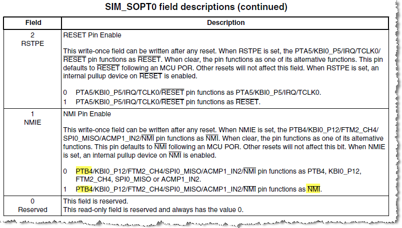

1,665 Views
Robin_Shen
Similar problems have been discovered before: Pin sharing not allowed between Capture and BitIO component (Kinetis KE06)
Taking into account the specificity of the PTB4 pin, would you please use other SPI pins?

piergiacomi
Hi Robin,
I need to use the PB4 pin for an output but it is blocked by the SPI for the DIN signal that I don't need and that I can't disable, can you help me?
