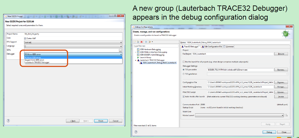

Thanks for your reply, but I don't have I-JET,JLINK debugger I have lauterbach debugger.In s32 design studio in debugger configuration section I didn't find lauterbach debugger option. So to use existing lauterbach debugger with s32 design studio what to do. Please reply.

      If you want to use the lauterbach in S32 studio, you need to install the lauterback Trace32 Eclipse plgu-in software.
      Please refer to this link to install it:
Help - Eclipse SDK
      After you install it, and restart your S32 studio, you will find the according selections.
