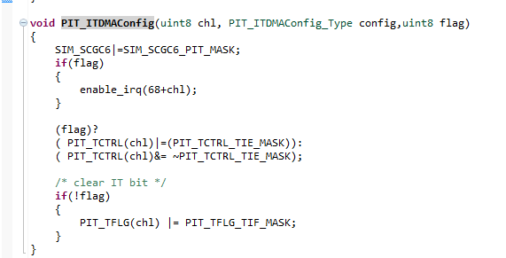

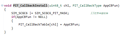

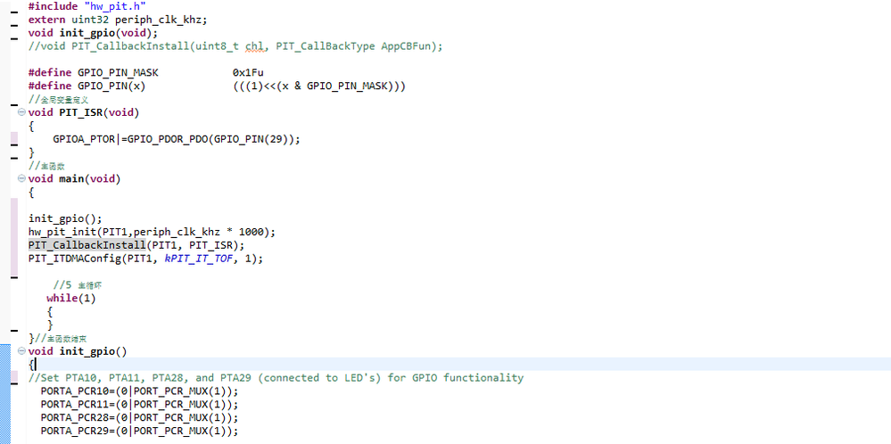

I am learning the PIT, but there is a problem.The program is built and debug successfully. When the program is running but it cann't get into the Interrupt callback function.1.png2.png3.png

I am not sure if this problem is solved after configure NVIC.
Please let us know if you fixed the issue.

OK, I have solved the problem, Thanks.
