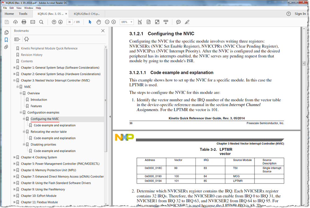

hello
I am learning the PIT, but there is a problem.The program is built and debug successfully. When the program is running but it cann't get into the Interrupt callback function.On the other hand, I don't know how to use the NVIC module.
the program is:
772 Views
Robin_Shen
I can's see your program, please attach these images again.
Please read the '3.1.2.1 Configuring the NVIC' of KQRUG(KQRUG ch).
