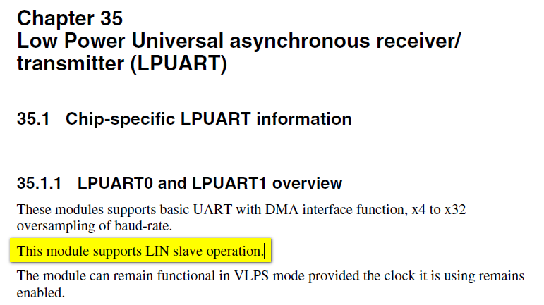

Whether there is a KL17 LPUART application note in a LIN slave operation or sample code for reference

Hi Eric Liao,
    We don't have the direct application note in a LIN Slave for KL17, but our AE team provided the UART validation code for your reference, which is for 120MHz part, but should be general , the LIN function nearly the same. Please kindly refer to attachment for more details.
    Besides this validation code, you also can refer to the KEA LIN stack, which can be download from this link:
LIN2.x and SAE J2602 Stack
   There also have the LIN Slave code for your reference.
Wish it helps you!
