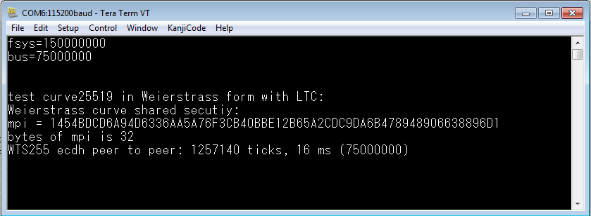

int ecdh_wts_curve_end( )
unsigned int ticks;
int ret = 0;
size_t blen = 0, blen_peer = 0;
ecdh_context ecdh;
ecdh_context ecdh_peer; // to_wts255
ecdh_context ecdh_peer_m255;
mpi R;
mpi_init(&R);
ecdh_init( &ecdh);
ecdh_init( &ecdh_peer);
ecdh_init( &ecdh_peer_m255);
MPI_CHK(ecp_use_known_dp( &ecdh.grp, ECP_DP_WTS25519 ));
MPI_CHK(ecp_use_known_dp( &ecdh_peer.grp, ECP_DP_WTS25519 ));
MPI_CHK(ecp_use_known_dp( &ecdh_peer_m255.grp, ECP_DP_M255 ));
blen = set_hash_buff(/*TEST_ECP_GRP_ID*/ECP_DP_WTS25519, &secret_buf, ecp_name);
if(blen == 0) {
ret = -1;
goto cleanup;
mpi_read_string(&ecdh.d, 16, WTS255_d);
mpi_read_string(&ecdh.Q.X, 16, WTS255_Qx);
mpi_read_string(&ecdh.Q.Y, 16, WTS255_Qy);
mpi_lset(&ecdh.Q.Z, 1);
mpi_read_string(&ecdh_peer_m255.d, 16, M255_d);
mpi_read_string(&ecdh_peer_m255.Q.X, 16, M255_Qx);
mpi_init(&ecdh_peer_m255.Q.Y);
mpi_lset(&ecdh_peer_m255.Q.Z, 1);
// map M255 point to WTS255 point
my_timer_start();
mpi_read_string(&R, 16, AM_INV3);
mpi_add_mpi(&ecdh_peer.Q.X, &ecdh_peer_m255.Q.X, &R);
mpi_mod_mpi(&ecdh_peer.Q.X, &ecdh_peer.Q.X, &ecdh_peer_m255.grp.P);
mpi_lset(&R, 3);
mpi_exp_mod (&ecdh_peer_m255.Q.Y , &ecdh_peer.Q.X, &R, &ecdh_peer_m255.grp.P, NULL);
mpi_mul_mpi(&R, &ecdh_peer.grp.A, &ecdh_peer.Q.X);
mpi_mod_mpi(&R, &R, &ecdh_peer.grp.P);
mpi_add_mpi(&ecdh_peer_m255.Q.Y, &ecdh_peer_m255.Q.Y, &R);
mpi_add_mpi(&ecdh_peer_m255.Q.Y, &ecdh_peer_m255.Q.Y, &ecdh_peer.grp.B);
mpi_mod_mpi(&ecdh_peer_m255.Q.Y, &ecdh_peer_m255.Q.Y, &ecdh_peer.grp.P);
mpi_mod_sqrt(&ecdh_peer.Q.Y, &ecdh_peer_m255.Q.Y, &ecdh_peer_m255.grp.P);
// z = 1
mpi_lset(&ecdh_peer.Q.Z, 1);
MPI_CHK(ecp_copy(&ecdh.Qp, &ecdh_peer.Q));
MPI_CHK(ecdh_calc_secret_wts2mont( &ecdh, &blen, secret_buf, blen, myrand, NULL));
mpi_sub_mpi(&ecdh_peer_m255.Q.X, &ecdh.Q.X, &R);
mpi_mod_mpi(&ecdh_peer_m255.Q.X, &ecdh_peer_m255.Q.X, &ecdh_peer_m255.grp.P);
ticks = my_timer_stop();
// print out message
polarssl_printf("Weierstrass curve shared secutiy:\n");
mpi_printf_string( &ecdh.z, 16);
polarssl_printf("%s ecdh peer to peer: %lu ticks, %d ms (%d) \n", ecp_name , ticks, ticks / (CLOCK_SYS_GetPitFreq(0) / 1000),CLOCK_SYS_GetPitFreq(0) );
cleanup:
if( ret !=0 )
polarssl_printf( "%s test Unexpected error, return code = %08X\n", ecp_name, ret );
mpi_free(&R);
ecdh_free( &ecdh);
ecdh_free( &ecdh_peer);
ecdh_free( &ecdh_peer_m255);
return( 0 );

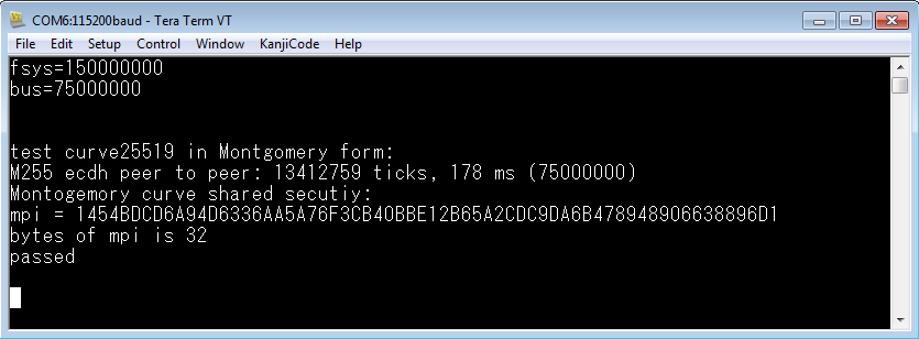

int ecdh_mont_curve_end( )
int verbose = 1;
unsigned int ticks;
int ret = 0;
ecdh_context ecdh;
ecp_point Q_peer; // peer public point
ecdh_init( &ecdh);
ecp_point_init( &Q_peer);
MPI_CHK(ecp_use_known_dp( &ecdh.grp, ECP_DP_M255 ));
blen_peer = set_hash_buff(ECP_DP_M255, &secret_buf_peer, ecp_name);
if(blen_peer == 0) {
ret = -1;
goto cleanup;
mpi_read_string(&ecdh.d, 16, M255_d);
mpi_read_string(&ecdh.Q.X, 16, M255_Qx);
mpi_init(&ecdh.Q.Y); // don't care Y, only init it
mpi_read_string(&Q_peer.X, 16, WTS255_Qx_TO_M255_Qx);
mpi_init(&Q_peer.Y);
mpi_lset(&Q_peer.Z, 1);
MPI_CHK(ecp_copy(&ecdh.Qp, &Q_peer));
my_timer_start();
MPI_CHK(ecdh_calc_secret( &ecdh, &blen_peer, secret_buf_peer, blen_peer, myrand, NULL));
polarssl_printf("Montogemory curve shared secutiy:\n");
polarssl_printf( "passed\n" );
cleanup:
if( ret !=0 && verbose != 0 )
ecdh_free( &ecdh);
ecp_point_free( &Q_peer);
if( verbose != 0 )
polarssl_printf( "\n" );
return( 0 );
4. Test result:
2. Test result of curve25519 in Montgomery form with software algorithm:
We could see that the shared security both in Weierstrass form with LTC and Montgomery form are “0x1454BDCD6A94D6336AA5A76F3CB40BBE12B65A2CDC9DA6B478948906638896D1”.
But the calculation speed with LTC was ten times faster than other one.
