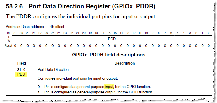

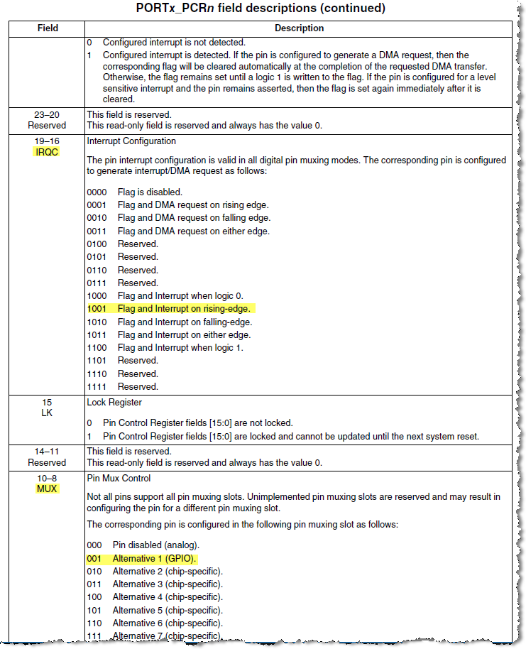

rajkumar_yerraj
Hi Robin
We have configured below registers:
1. IRQC as 0x09 for interrupt on rising edge
2. GPIOx_PDDR as 0 for input
3. GPIO functionality as MUX(0x01)
You can see it in the following screenshot.
We are not getting interrupt.
Can you suggest what could be the reason?

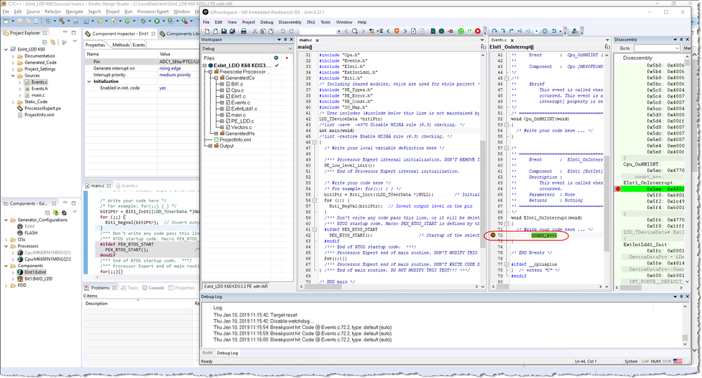

Robin_Shen
Would you please attach your project here, so that I can direct test it?
I am using KDS3.2 configure the ExInt_LDD, I try to connect the PTE2 with PTE4 pin. If I toggle PTE4, the interrupt will happen.
Robin

rajkumar_yerraj
Hi Robin,
We have configured the same way as you mentioned in the previous discussion and we are getting the interrupt only sometimes and sometimes it is not( i.e., Transition from low to high ) only when in debug mode by putting break point at that point in Events.c . When ISR is not called, interrupt pin remains HIGH.
So, what could be the issue that I am unable to get a continuous interrupt ?
I am sorry, as per company’s policy we could not share you the whole project, I am attaching the files in which the External Interrupt is configured.
