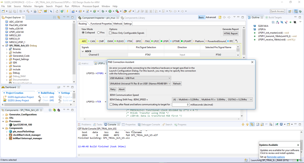

I was using PE MICRO universal multilink FX for debugging my project.

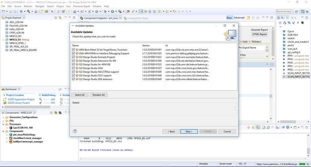

Ir was working fine for me until i updated my S32DS IDE and the firmware of PE MICRO universal multilink FX also got updated automatically when i tried to debug it.
Now PE MICRO universal multilink FX is not responding properly.

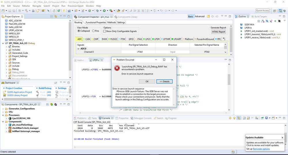

It is unable to enter DEBUG mode.
After clicking on ABORT, i got the following message.
I have re--installed the S32DS older version(the one without updates) still it is not working fine.
I think reverting back to older version of firmware may resolve the issue. If not, please suggest an alternative.
How to revert back to older version?

which version of S32DS you use? Which update did you install?
We have no other similar incidents with S32DS and PeMicro debugger.

S32DS version:
S32DS_ARM_Win32_v2018.R1_b180326
Which updates did i install???
But even after uninstalling the software and reinstalling it with older version(without updates), it is not working properly.
