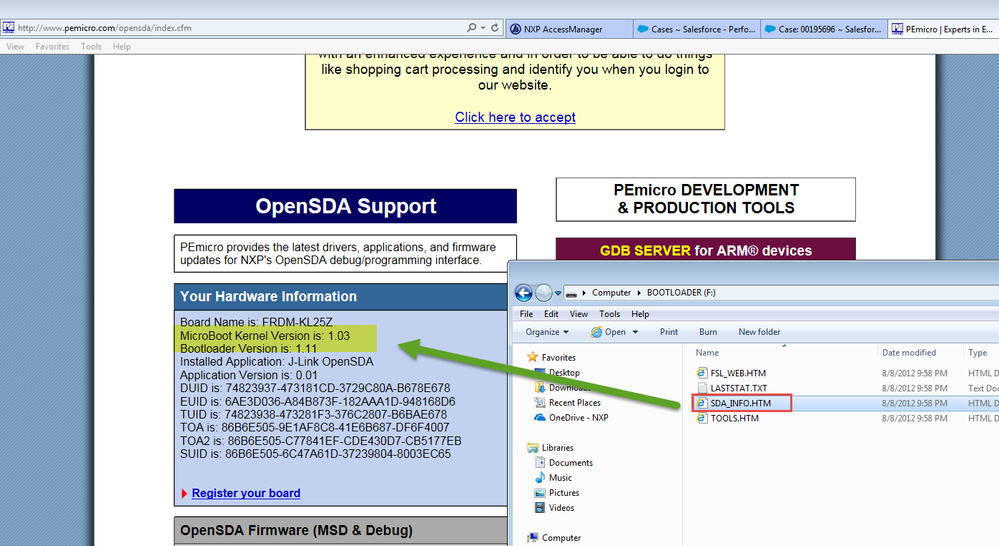

    Please use your board, enter the bootloader mode, then open the SDA_INFO.HTM, check the bootloader version:
As I know, the opensda1.x is not the open source code, so we also don't have that K20 firmware.
So, please check your opensda version, whether it is 1.x or not?
If it is really opensda 1.x, you also can check it in this MPC community:
MPC5xxx
Just let the MPC engineer to check whether there has the according opensda opensource code for you.
