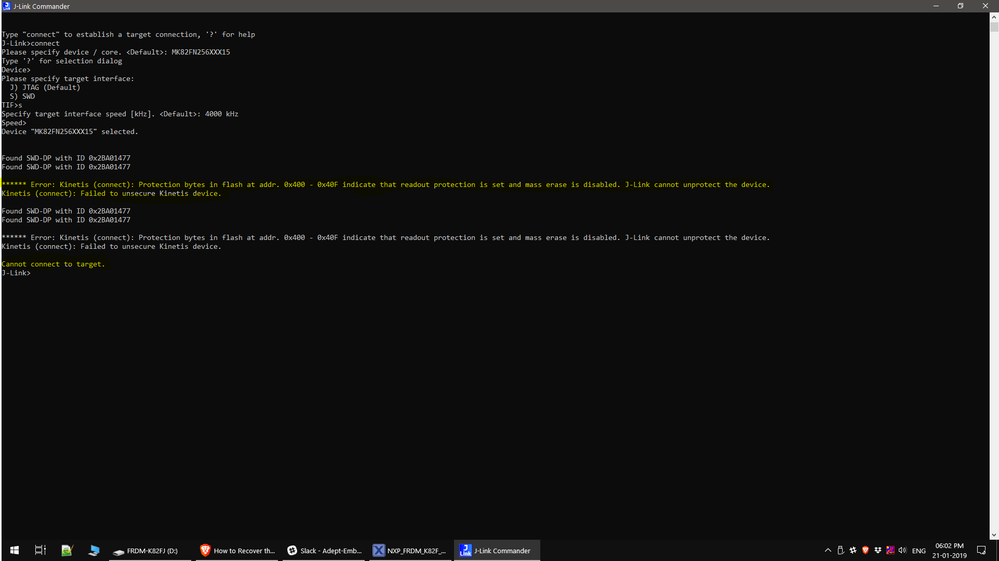

I recently purchased FRDM-K82F Board.
I downloaded all software from the official website along with the drivers and make necessary setup in windows 10 PC.
My config. is as follows:
PC Config : Windows 10 x64
IDE : MCUXpresso IDE v10.3.0_2200
SDK : SDK_2.5.0_FRDM-K82F
Debugger : J-LINK SWD Debugger (without any external Hardware)
From the examples, i used LED_Blinky example and successfully ran LED Blinky program in Board.
Now, from next time whenever i try to debug the same example without any modification, It is showing following error.
Error :
Kinetis (connect) protection byte in flashat addr. 0x400 - 0x40F indicate that readout protection is set and mass erase is disabled.J-Link can not unprotect the device. Can not connect to the target.
Please, provide the solution. I want to unprotect my FRDM-K82F Board and want to use it for different applications. Provide a way to use it.Connect Error.PNG

I found many files that contain the flash configuration field related definitions in FRDM-K82F project folder files.
files are as follows:
\device\MK82F25615.h
here search for FTFA_FSEC_SEC(x)
\drivers\fsl_ftfx_adapter.h
\startup\startup_mk82f25615.c
here search for Flash_Config = {0xFFFFFFFF, 0xFFFFFFFF, 0xFFFFFFFF, 0xFFFF3DFE};
My aim is to modify security related register bits to unprotect device (FRDM-K82F).
Which file/files can be helpful to modify the security-related bits. Is it listed here or I need to find another file. Please specify here.

mdisharat
Ok.
My aim is to debug my program onboard multiple times (edit/debug cycle).
Now, I get to know about security-related registers from the following link: How (not) to Secure my Microcontroller | MCU on Eclipse . This Link describes the registers to protect, secure or (not) and to change the setting of mass erase functionality with respect to  FRDM-KL25Z Board.
That configuration is located at address 0x400-0x40F for the KL25Z. The Flash Security Byte is at address 0x40C.
So, Can I say these address ranges are same for FRDM-K82F Board?
If is it different one then please provide that details. I have to deal with only FRDM-K82F Board.
Thanks in Advanced.
3,469 Views
miduo
Well, I am really do not know what you had done with the board... Please be note that the only method to recover a secured device is to launch a mass erase command. If you have secured your device with mass erase disabled, then the device is bricked, because this is what it is supposed to do when you have those bits set :-(
See detail information on "Secure Kinetis " here:
The only solution you have is to un-solder the MCU and replace it with a new one on your board.
