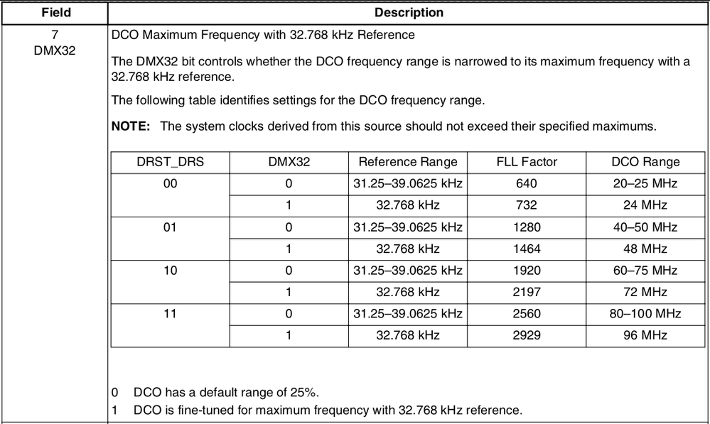

I am working with your FRDM K64F in bare metal. I read Chapter 25 (MCG) of the reference manual and I have managed to rise the clock frequency to 24 MHz using the FLL module by setting DMX32 bit in MCG_C4 register right after a system reset. However, when trying to rise the clock frequency by changing DRST_DRS bits in  MCG_C4 register to any other value different to 00, the program crashes. How can I achieve 96 MHz clock frequency shown in the table below? I am currently working within FEI mode, which is the default mode after a system reset.

See http://www.utasker.com/kinetis/MCG.html for a bare-metal programmer's guide to using the MCG.
Don't forget to correctly program the bus and (especially) flash clock dividers before setting a fast FLL: Out of specification flash clock will otherwise cause immediate failure.

Whenever you change the clock of the MCU, you must wait until the clock signal stabilizes before executing any instruction, otherwise your program will most certainly crash.
You can use the clock Config Tool of MCU Xpresso to select the MCG configuration that you like and apply it to your MCU through the clock SDK driver (fsl_clock.c).

Thanks a lot, after checking the divider value from Flash clock, I was able to rise System clock up to 96 MHz.

Thanks for the feedback!
Yes, flash clock is very critical - even setting its clock to 1MHz above its maximum allowed frequency for a single instruction period can cause immediate failure!
