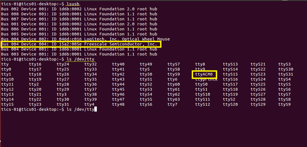

How to read usb serial of k70 tower board using putty on ubuntu
1,088 Views
sameerarvikar
I can read usb serial (i have put uboot on the kit)on in windows but when I connect it to ubuntu I cannot see ttyusb0 ,the kit is detected as I can see using dmesg
The kit is twr-k70F12.0M
973 Views
jorge_a_vazquez
Hi sameer arvikar
In Ubuntu OS, CDC devices are recognized as ACM components. ACM described how devices conforming to the Communications devices class (CDC) should present themselves to the USB host. I connect the same board and you can see in the following image how it is listed.
Hope this information helps you
