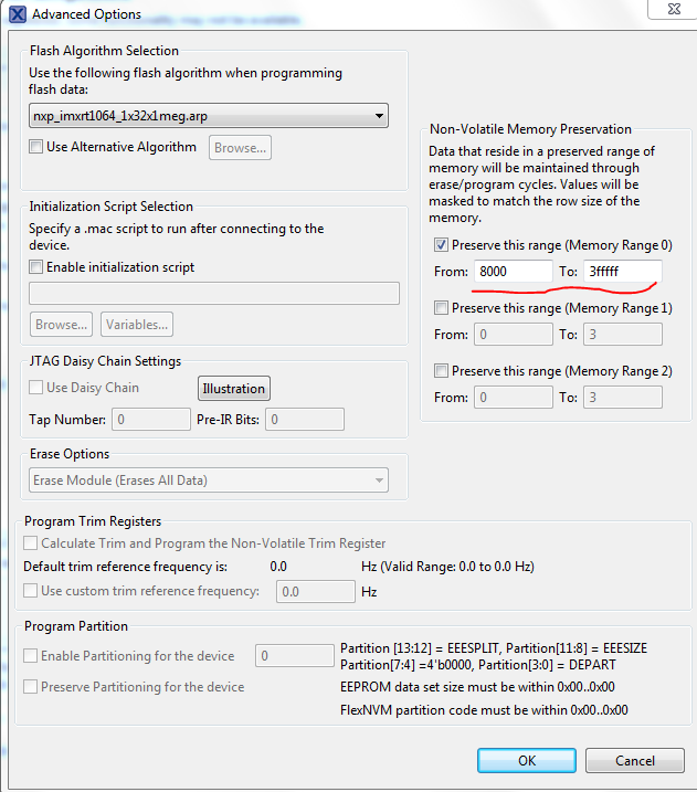

I am using IMX RT1064, MCUXpresso IDE and PE Micro debugger. I am developing a Firmware Update feature into my project. So, I have two application binaries; one is bootloader binary and another is application binary.
Bootloader @ 0x70000000
Application @ 0x70008000
I want to flash the application binary at the address and debug the bootloader. While debugging the bootloader, I do not want to mass erase the flash. To achieve this, I have preserved the application memory in the bootloader debug configuration setting (Shown below) but it gets erased when I debug the bootloader.
Are there any additional configurations that I am missing while debugging the bootloader?

1. bootloader code
 Please note, from 0X70000000 to 0X70002000, you need to put the Flash device configuration block, IVT, BD, DCD data,  then from 0X70002000, you can put your own bootloader function code.
2.  You said your Application @ 0x70008000, and don't want to erase it before download the code.
   In your preserve range, can you try the address with from 0X70008000, to 0X70008000+-0x3fffff?
After you test it, please share your result with me, thank you!
