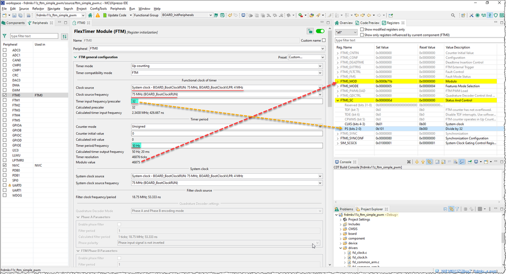

Hi le27,
Peripherals tool can help know what is the suitable value of prescaler.

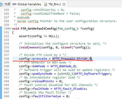

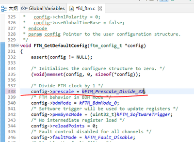

You shall get error by using kFTM_Prescale_Divide_1 of FTM_GetDefaultConfig. Please change the prescale :
config->prescale = kFTM_Prescale_Divide_32;
Robin

Robin_Shen
Hi le27,
Robin

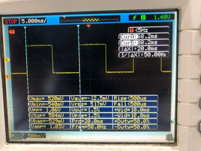

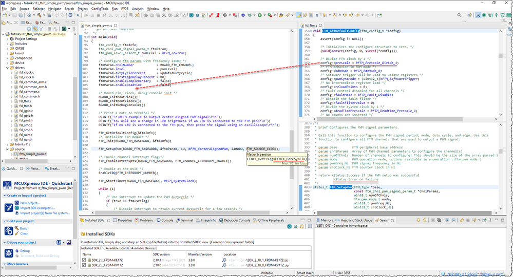

Thank you for your reply and guidance. I followed the method and modified config->prescale = kFTM_Prescale_Divide_1 to config->prescale = kFTM_Prescale_Divide_32; directly in the file of fsl_ftm.c. It can be observed that the LED on the control board changes gradually according to the change of duty_cycle Bright and gradually dimming, there is no problem, and the PWM output signal with a frequency of 50 Hz can be reached through the oscilloscope.

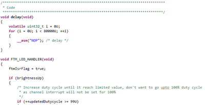

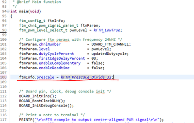

Then try to add ftmInfo.prescale = kFTM_Prescale_Divide_32; to the file of ftm_simple_pwm. I want to set the prescale from this, but maintain config->prescale = kFTM_Prescale_Divide_1 in the fsl_ftm.c file; the execution result shows that no PWM signal is generated, which is not clear. Is there a mistake in the use of the program?

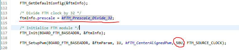

Robin_Shen
The arrow in my picture is a bit misleading.
Please put  ftmInfo.prescale = kFTM_Prescale_Divide_32; between FTM_GetDefaultConfig and FTM_Init

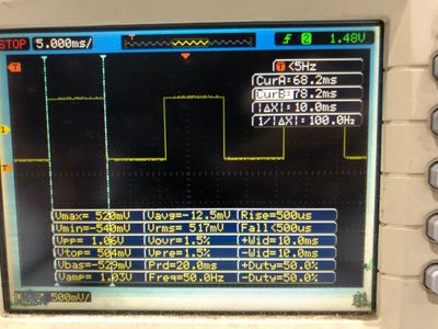

Now it is possible to generate a PWM signal, but encountered it again.
Set to 50Hz PWM frequency, it is only 71Hz from the observation.

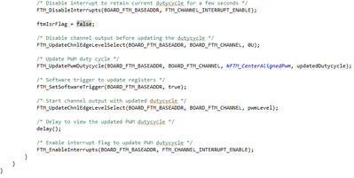

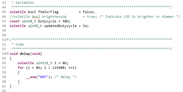

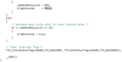

I don't know why the 50Hz PWM signal is not generated. I think this is caused by the delay. I go to DELAY place to modify it. From the original 80,000 to 115400, the KV11Z development board can be generated from the file is a 10M crystal oscillator, calculate i=1 =0.1us, the direction is estimated to be 115400 by trial and error, and set the fixed duty cycle to 50%.

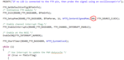

Finally, the required Hertz PWM signal and duty cycle can be obtained. But I still don't know if this is the correct way. I think it should only be necessary to adjust FTM_SetupPwm (BOARD_FTM_BASEADDR, &ftmParam, 1U, kFTM_CenterAlignedPwm, 50U, FTM_SOURCE_CLOCK); the PWM frequency value in this row can be used to obtain the desired PWM frequency.

Do you ever check the results of "FTM_SetupPwm"?  First off it has a number of asserts which may cause the application to hang without any kind of indication.  Secondly, "FTM_SetupPwm" may return an error value but continue executing as if there wasn't a problem.
I believe the most likely error will be that FTM_SetupPwm is returning an error code because the calculation done by "FTM_SetupPwm" for 50Hz results in values which can't be generated by the hardware.
That's a very low speed - you're probably going to have to create your own PWM using a timer.
