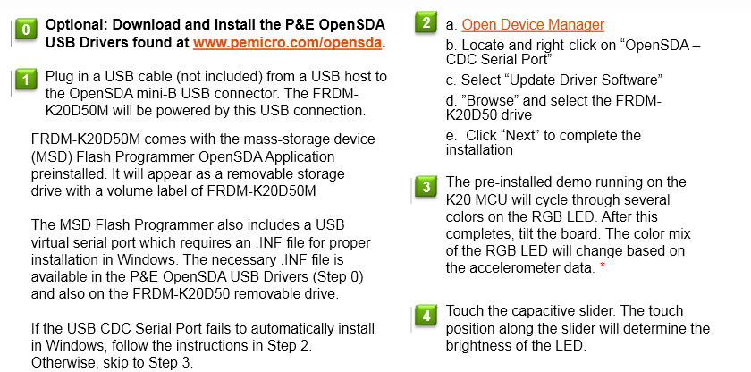

I have the latest drivers from P&E, but the FRDM-K20D50M is not recognised by P&E PROGARMCORTEX or by CodeWarrior MCU 10.4.
4,194 Views
BlackNight
Mark,
have you loaded the debug application with the bootloader already?

hectorsanchez
Try to follow these steps:
If windows does not recognize your board as an removable storage drive , try to reinstall the P&E drivers
