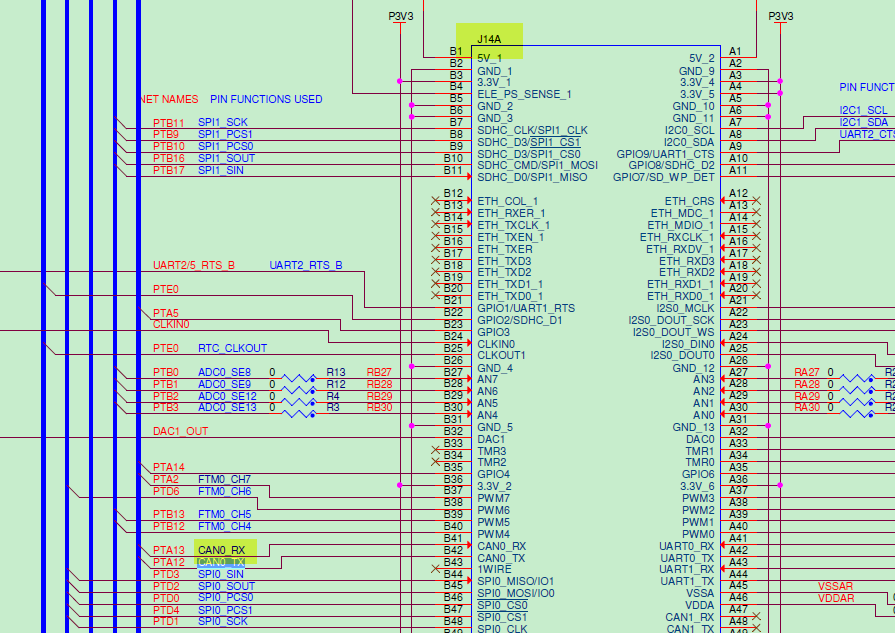

Hello, Looking to develop a new product based on an existing MCF5213 Coldfire design. The MCF5213 would be perfect except it is in Not Recommended for New Design status (NRND). Almost any Kinetis MCU with CAN would work but we would like to pick a main stream part with lots of the usual features so the MCU could be used in other product in the future. I though the K22 with CAN would be good but I can not figure out how to connect to the CAN bus on the Tower Board. I know there is a TWR-SER (Serial Module) with CAN but I dont see how the TWR-K22F120M  connects. Looks like the connections to the elevator cards are not there.
To make a long story short. I'm looking for a main stream general purpose Kinetis MCU with CAN that has the CAN bus accessible on a Freedom or Tower board. Any suggestions?
Thanks!
Mark

The K22 on the TWR-K22F120M doesn't have a CAN controller in it and that is why there is no connection. There are quite a number of Kinetis parts that do though and can be used in the tower kit.

   Mark Butcher's reply is correct, the chip on TWR-K22F120M don't have the FlexCAN mode, that's why you can't find the according connection.
   I suggest you to use the TWR-K21F120M board, this board have the flexcan module and the according connection:
Wish it helps you!
