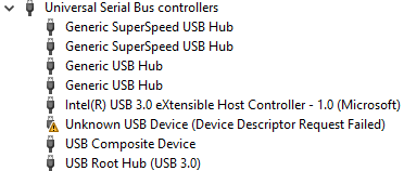

Looks like the OP has not responded but I'm having this same problem.  I also have a FREEDOM-KL02Z board which I've been able to use your guides to update the bootloader and load the Segger application, so I think everything else in my Win10 setup looks OK (all the Win10 services workarounds).  With the firmware loaded in the FREEDOM-KL05Z from the factory, the board appears as "USB Drive D" (on the FREEDOM-KL02Z this drive appeared as "BOOTLOADER") for a few seconds after plugging it in but then disappears.  A few seconds after that I get the "USB Device not recognized" Windows error.  Holding reset while plugging the board in to enter MSD mode seems to have no effect.  The SDA LED is solid green.

So your KL02Z shows up with "BOOTLOADER" and then as "unrecoginized", right?
It seems to me that somehow it enters bootloader mode and then even this fails. 'Device Descriptor Request failed' means that the host PC started communicating with the board, but then the board did not respond.
I have not seen something like this (yet). I assume you already tried with a different USB cable and USB port?
Other than that I think your K20 on the board might be damaged (ESD maybe?).

Yeah, I was afraid it might be bad hardware.  Luckily I had a good board to prove out the USB port and cable, so I didn't spend too much time chasing my tail.  Thanks again for the help.
