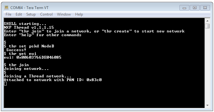

I tried running the section 10.5, you will see a difference when you send the command thr joiner view
Documentation:
$thr joiner view
Index EUI PSK
0 0xFFFFFFFFFFFFFFFF kinetis
Actual result:
$thr joiner view
Index EUI PSK
0 0xFFFFFFFFFFFFFFFF THREAD
I attach some screenshots from the process I followed:
REED (Node A)
ED (Node B)
Estephania
