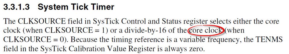

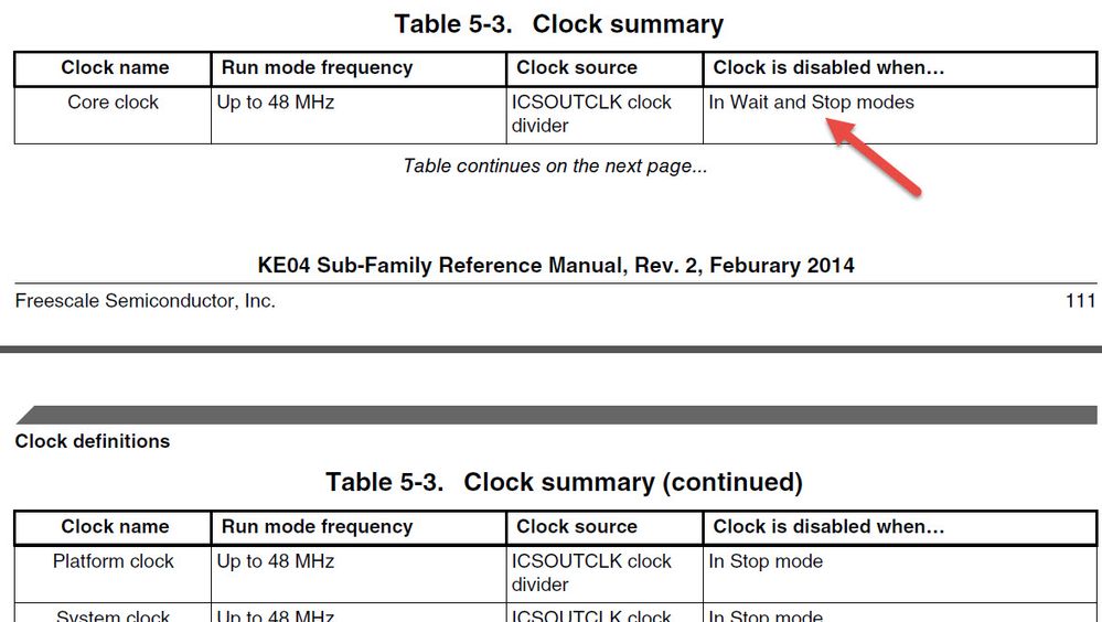

I think I already figured out the fundamental reason this issue that systick interrupt couldn't wake up the MCU from the STOP mode.
After you've had a brief look through the KE04's RM, you can find that the core clock provide the particular clock source for the systick (Fig 1), however the core clock will become disabled when MCU works under either Wait or Stop mode (Fig 2).
Wish it helps.

jeremyzhou
Hi Hi Yasuhiko Koumoto,
I think the platform clock still be available in STOP mode too, not the BUS clock and this clock's never mentioned in the RM yet.
However it actually exists according to the reply.
Ping

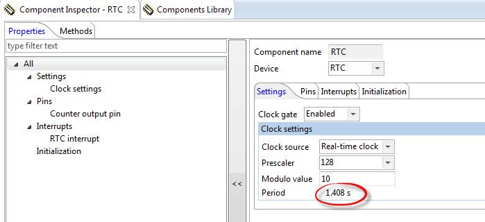

jeremyzhou
Of course, welcome to join the discussion.
I've configured 1.408s as the RTC interrupt period as an example in the project, not the 10ms.

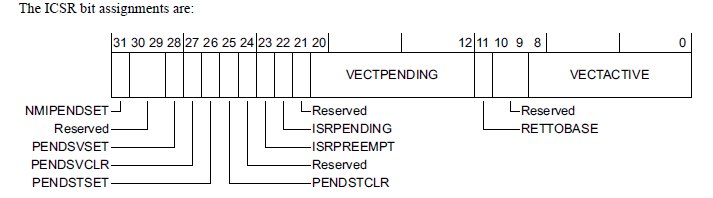

I guess the reason that SysTick interrupt makes the MCU up would be SysTick Interrupt had been pending before executing WFI instruction. Also in the case, WFI will skip to enter the WAIT/STOP mode. You had better clear pending of SysTick interrupt before execution WFI by writing 1 to ICSR.PENDSTCLR (bit 25 of 0xE000ED04) .

yasuhikokoumoto
Senior Contributor I
Hi Abdullah Kahraman,
I don't mention NVIC_ICPR but mention ICSR because SysTick interrupt is out of NVIC control.
CPU core interrupt pending would be cleared by ICSR (0xE000ED04).
To clear SysTick pending,
*(long *)(0xE000ED04) = (1<<25);
As the register includes SysTick interrupt pending set bit (bit 26), you cannnot write all "1" into it.
