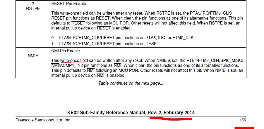

hi, everyone! i am using the KE02Z64's NMI Pin(Pin 13, in 44-LQFP package) as GPIO. in the datasheet,it reads that,捕获.JPG.
i am wondering where & when to write NMIE bit?  before the processor enters the "main",e.g. in __init_user(), or whenever in "main" or elsewhere?

ok. this question has been solved! i write the NMIE bit in the in __init_user().
