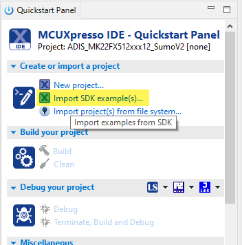

ErichStyger
Specialist I
Hi @ALP1 ,
not sure if your question is clear to me, but: importing examples works that way:
If your question is how to use example code for the LPC55S16 then the answer is not simple: what I'm doing is using the McuLib which is based on the SDK and allows me to use code for Kinetis, LPC and i.MX (and others). You see an example for this here: https://mcuoneclipse.com/2021/05/15/using-fatfs-and-minini-with-the-nxp-lpc55s16-evk/
Otherwise: it really depends what you need. You might have a look at the https://www.utasker.com/index.html project which provides a cross-device platform and framework.
I hope this helps,
Erich
