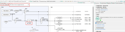

Hi @sn2
I tested on my side. It can't reach 100 MHz, but it's almost 96 MHz. The configuration is as below:
Hope it helps.

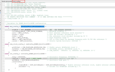

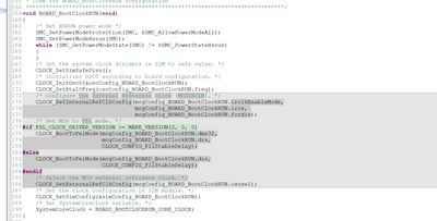

Hello @sn2
I'm sorry, but according to our company policy, I'm unable to share the code. However, this process is quite simple. Please refer to my configuration settings—especially the ones highlighted in the red box.
Then  click  update code button, the system will automatically generate the necessary code as below.
