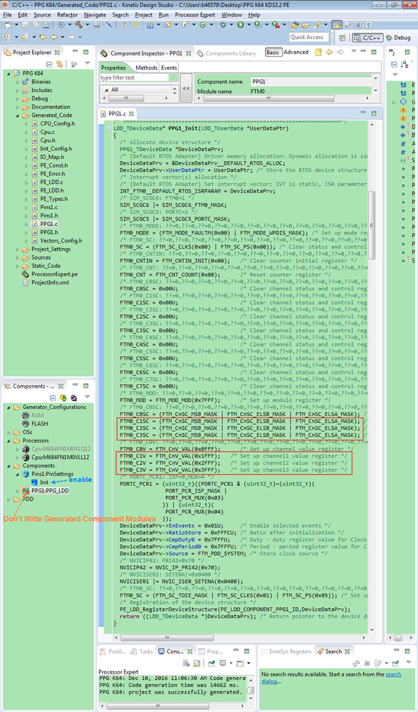

Robin_Shen
You can configure these pin mux as FTM function through "Pins1:PinSettings". (The Pins1_Init is generated in Pins1.c after enabled.)
If you want FTM 0  to have the pwm signals present on those pins, manually configured channel registers in PPG1_Init function. You need right click "PPG1:PPG_LDD" configure "Code Generation", otherwise the Processor Expert will overwrite the code that you write. See below:

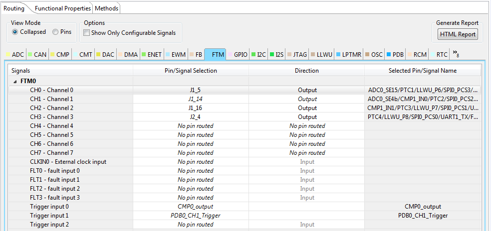

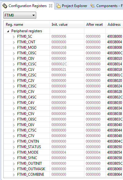

Designer11
I then manually configured the remaining pins to be FTM output. But they still no pwm output on the channels that were forced to output pwm. Below are screen captures of the configurations.
