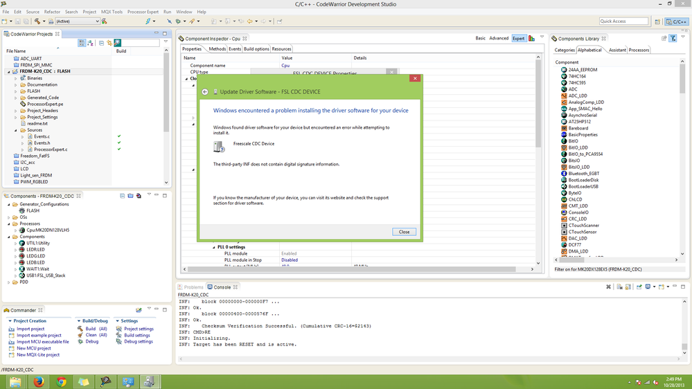

Hello
I want to configure the USB but it is not being detected by the PC, I have tried with both TWR and FRDM k20d50m boards. I changed the uc in the example code given in codewarrior 10.5 and after building it I dumped the code in the uc but still no device was discovered. I also went through the blog MCU on Eclipse | Everything on Eclipse, Microcontrollers and Software but still couldn't figure out how to deal with K20D50M boards. Kindly look into the matter.
Thanks in advance
Amit Kumar

I have attached a project I use with the FRDM-K20 which uses USB CDC.
That project is available on GitHub here: mcuoneclipse/Examples/FRDM-K20D50M/FRDM-K20_CDC at master · ErichStyger/mcuoneclipse · GitHub
The project is described here:
USB CDC with the FRDM-K20D50M | MCU on Eclipse
I hope this helps.

BlackNight
It looks like you are using Windows 8? 8.0 or 8.1?
I do not have Windows 8, but it looks like it only allows you to install signed drivers?

Hi Erich
The driver problem was resolved by allowing the installation of unsigned driver in the windows settings.

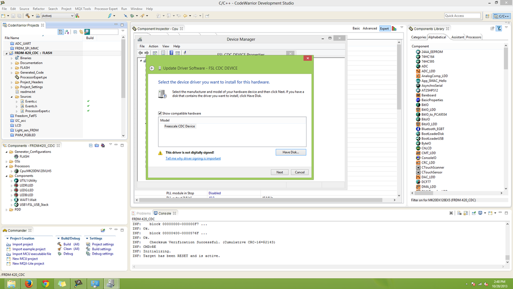

Amit_Kumar1
Senior Contributor II
Hi Erich
I am having problem in updating the driver, When I browsed the required file an error message appeared that the driver is not digitally signed and it didn't updated.
after clicking next, the following message displayed
How to resolve this issue ?
thanks and regards
Amit Kumar

Amit_Kumar1
Thanks a lot Erich. It worked  :smileyhappy:
