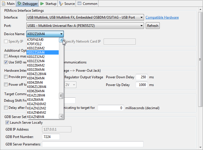

What setting is needed in Kinetis Design Studio to allow the software to communicate through the P&E Multilink Universal to the MKE02Z16?

I found a document through a google search: https://community.freescale.com/servlet/JiveServlet/previewBody/100713-102-2-15710/kds-v1.0.1beta_qu...  The directions were clear; however, my processor KE02Z16VLD2 was not available. I had to settle for a KE02Z16M2 selection.

BlackNight
I don't have that device, but I would say it should be this:
