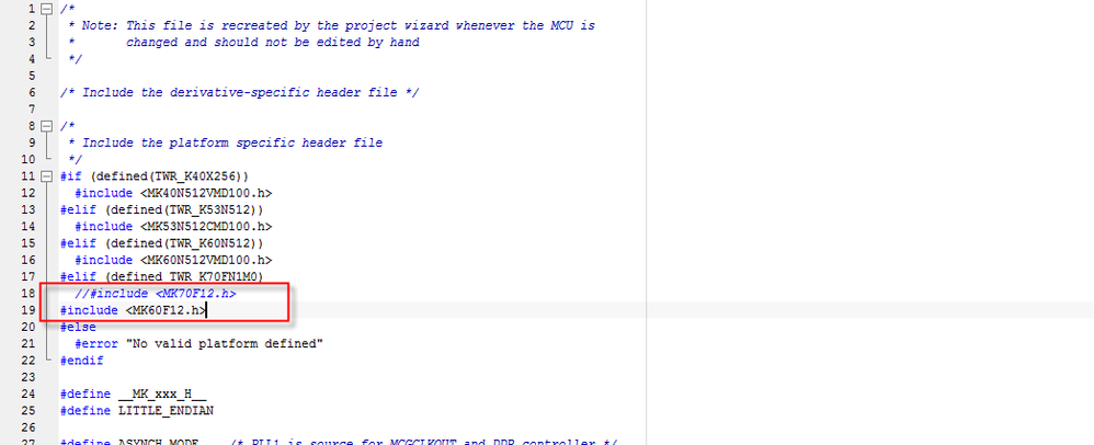

1. Replace the device header file.
Use MK60F12.h instead, which may be extracted from KINETIS_120MHz_SC(Kinetis 120MHz bare metal sample code) , and put this header file in the folder of "C:\Freescale\Freescale USB Stack v4.1.1\Source\Host\source\bsp\P3" for Host or "C:\Freescale\Freescale USB Stack v4.1.1\Source\Device\app\common\kinetis" for device, and modify derivative.h as below:

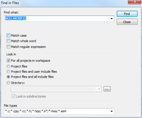

in MK60F12.h, MCU_MK60F12 is defined instead of MCU_MK70F12, so in this step we will have to change some code snippet related with MCU_MK70F12.
Firstly search MCU_MK70F12 in the project, for example , in the Host demo USB_MSD project based on IAR, you may do that as below:
and you may find some macro like "#ifdef MCU_MK70F12" or "#ifndef MCU_MK70F12", and change them as below:
#ifdef MCU_MK70F12 ----> #if (defined MCU_MK60F12) || (defined MCU_MK70F12)
#ifndef MCU_MK70F12 ----> #if (!defined MCU_MK60F12) && (!defined MCU_MK70F12)

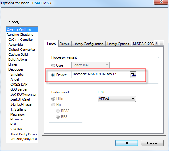

4. Set the correct device type in IDE settings.
For IAR, change the device family in view of project options.
Now, you can start to run the USB demos on TWR-K60F120M, please note the above steps is ok for USB device stack, but USB Host stack has some code issue , as mentioned in [USB stack ver 4.1.1] a code issue in msd_mfs_generic host demo , so please fix the issue before going further.
